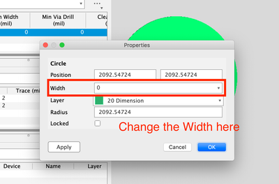

As you mentioned, the reason of this issue is that the width of circle is zero. The 'circle width 0' is a  intended behaviour in Eagle side for silkscreening related behavior. But I think it is a bug when draw Circle as board shape and I have reported it to our Develop team. Sorry for the inconvenience.
Beside the workaround your mentioned, another workaround is that you change the width of the circle in the Properties Dialog (Click on the Solid Circle -> Right Click -> Choose Properties -> Change the width to non-zero value manually)
Then you can use the circle board and do AutoRoute again.
