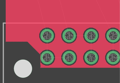

Problem:
I created my own custom parts, because i need exact these "special" parts for my PCB. So i created everything on my own and now i have the problem that the PTH-Pads of my custom parts won't connect to the polygon i want to use.
All footprint of the custom parts have active thermals option and i tried also everything with the net_classes. To change the PCB rules also changed anything as you can see in the pictures.
The reason why i want to use the polygon is that i have to transport a high amperage over it.
Question:
Is there any reason why the polygon won't create thermals to the PTH-Pads even if they are in the same net_class?
Or am i do something completely wrong?

If you design in your polygon in the footprint, you wont get thermals.
If you add the polygon later, in the board editor, you can have thermals (give everything the same net name).
It's a shame it cannot be done in the footprint, as it would be nice to have everything as ONE finished part.

I added the polygon not to the footprint but to the PCB-Sketch. So the footprint does not contain any polygon.
I tried everthing with the net_class but the results looked like the pictures above.
Airwires and polygon were in the same net_class.
I searched a long time to figure out if i set wrong settings or something like that, but all tutorials and videos i found tell me the same things i did/tried. 😞

You need to connect all your pads and the polygon to the net, otherwise they will not connect.
Connect the pads in the schematic and use the NAME command in PCB to connect poly and pads.
You can also connect all the pads together in the footprint. That might be easier. Then you'll just have ONE pin to connect to in the schematic.

It is not a workaround, it's how it's supposed to work and how it's always been.
If you want to use the "features" of a polygon like thermals, isolation, rank e.t.c., you HAVE to add it in the PCB editor, where the DRC rules will be applied. You cannot do that in the footprint.
The polygon, in footprints, is mostly used for making complex footprints.
No need to draw any traces if you do it this way, it will all be automatically connected.
