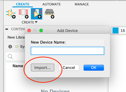

How can I merge many libraries into only one? And how can I import symbols and footprints from other libraries?
I'm missing these functions like i had in Eagle.
2 REPLIES 2
I can’t say for merging libraries, but you can now import footprints and symbols from other libraries as of the May 2020 update. Start by clicking on the corresponding add button, then click on import.
Hello @mathias.obetzhauser ,
Yes, @everettac  is correct.
Now you could import the device/footprint/symbol in the latest Fusion release build 2.0.8335 and later.
Or you could go to schematic or brd file -> right click one component -> select Copy device/footprint/symbol to current open library in Fusion.
Hope it helps.
