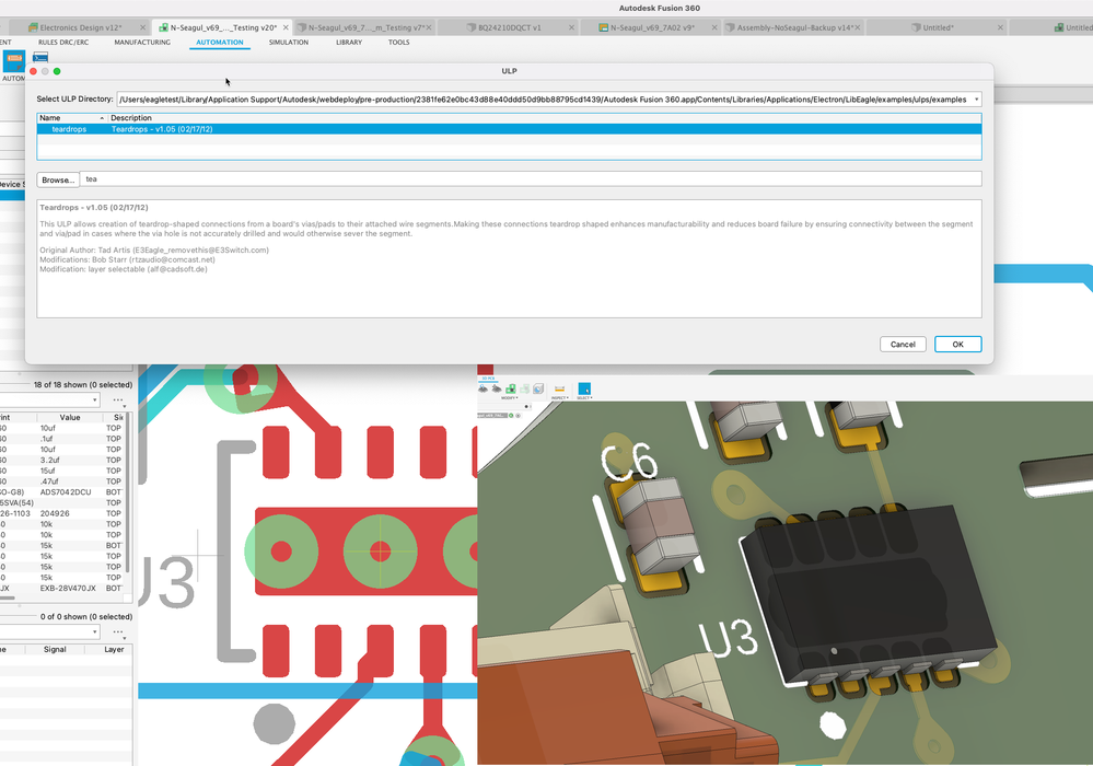

Improved the performance of Fusion 360 electronics when running scripts, and ULP execution
EAGLE users are used to the snappy performance in EAGLE. With Fusion 360 electronics, users have experienced a performance drop when executing scripts and ULP's (User Language Programming). With this update, you will notice a staggering 60-100x improvement in performance when running ULP's and scripts.
We used the Beagle Bone Black Wireless to test the performance of some of the mainly used ULPs and scripts:
ULP Name
EAGLE v9.6.2
Fusion 360 update
Teardrop.ulp
4:10 Minute
6.5 Seconds
Teardrop Undo
6:02 Minutes
3.5 Seconds
cmd-renumber
9 Seconds
2 Seconds
Panelize
55 seconds
3 Seconds
Copy-silkscreen
3:50 Minutes
10.5 Seconds
Import DXF
3:10 Minutes
5.5 Seconds

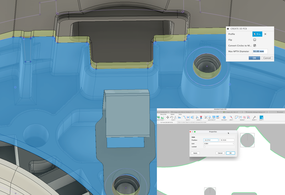

Design Space Sketch circles get converted to holes in the PCB
 Initially, the holes you defined in  Fusion 360 design workspace came in as circles on the Dimension layer in the  PCB editor. We have updated this by replacing the circle for holes in the PCB, defining a proper hole-to-hole relationship for appropriate manufacturing output.

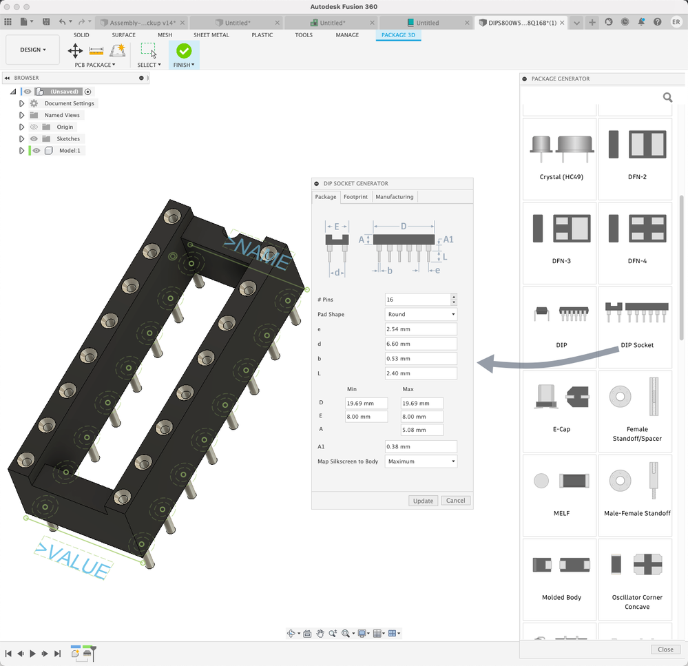

Added Template for DIP socket package in the Package Editor
 DIP sockets are commonly used on designs that require components to be easily replaced, such as programmable devices. The new DIP Socket package is another addition to the existing package editor templates available in the package editor. Our goal with the Package generator is to support all IPC Standard and as many non-IPC footprints as possible, and each new type of component gets us closer to that goal.
