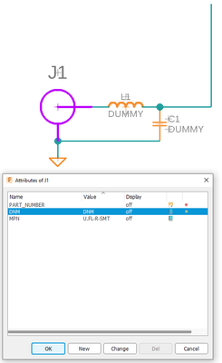

2. BOM file contains a part I created without any bits
I have created a libary component called "surface conenctors" that is surface connectors that attach to my device.
However it results in BOM
Q: How do i/should I eliminate components which are just traces, from BOM ? the pads are connected to other components of mine.

For excluding components from the BOM you can use attributes and some manual labor.
I use an attribute called Do Not Mount (DNM). I then have a python script that sorts out all components with that attribute. You can do something similar in Excel or LibreOffice.
Good luck!

BOM -
Ok so removing them isn't anything particular,  I can just go in the file and cancel the lines i dont want since my component list ins't long enough to warrant a python scipt
