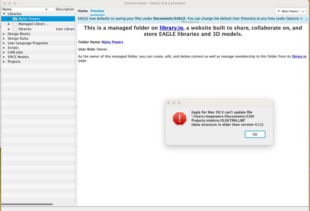

Message 9 of 12
myles_e_powers
Also downloaded free copy of EAGLE:
Message 10 of 12
jorge_garcia
Hi @myles_e_powers ,
Try this one, this library is very old and going from 4.09 to 4.11 there was an incompatibility between OSes. This required opening older files in Windows EAGLE after version 4.11 and then saving the file. This would update the format and now EAGLE 4.11 and newer on Mac and Linux would be able to open the file.
This file should work.
Let me know if there's anything else I can do for you.
Best Regards,
Jorge Garcia
