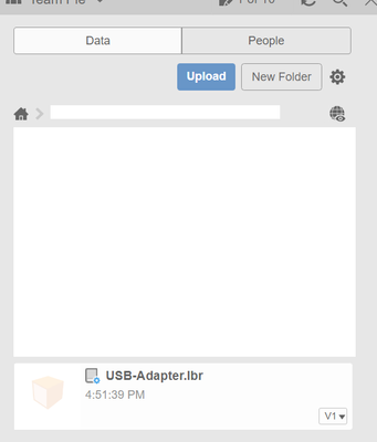

I imported the file you attached to the project folder, however that file does not show up in the "Library Manager".
I tried dragging the file over from the Team View shown below into the Design Manager - Parts window but that did nothing.

ThePieMonster
At a loss of what to do here...
I can see the lbr in the project folder, but it does not show up. I actually have two lbr's that are not showing up here.

ThePieMonster
So it seems "uploading" a lbr in the project/team window is different then "opening" the lbr file which then imports it to the same place. The first just uploads a dummy file, and the later actually imports the library.  😓
