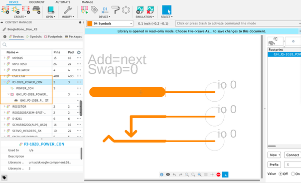

Hi @christopher2KLSVU , @markY6RWE ,
For the package offset issue, we will have a look, sorry for any inconvenience.
And for your reference, we have a PJ-102B_POWER_CON device in the shared BeagleBone_Blue_R3 library if you need it in the future.
You need to use it from Library Manager -> Available List, which will be shown in the In Use tab and could be added from the Add Part list in the future.
