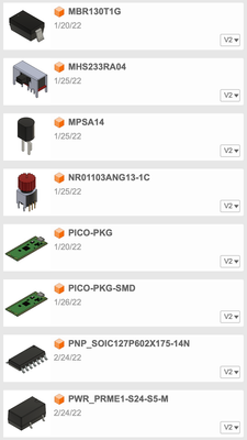

remiBB5EP
Thank you @jorge_garcia for the information. It helps.
While I agree with footprints and schematics, it is laborious when you have to design the 3D models of all the components. Resistor, Capacitors and standard chips are fast to draw but other components are not so fast to design.
As an example those are the one I had to do myself for my last project:

jorge_garcia
Hi @remiBB5EP,
I commend you, you are very proficient at modeling the components. For the 3D models you can usually get those from the manufacturer directly. It's a pain but it can often save you the work of modeling the part yourself. The plug-ins we've spoken about are the easiest way to get a 3D model without having to make one yourself. In the meantime we are working on making 3D models more re-useable so that you can just grab existing 3D models from other libraires.
