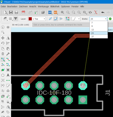

For routing (not wire-command) in eagle 9, i configurated the with-menu with the following script command (placed in eagle.src):
SET WIDTH_MENU 7 9 12 25 27.
That worked pretty well.
This Command works in fusion (no error / exception), but it only set the menu for the wire command and not for the route command.

I hope you're doing well. I can reproduce this, I'll make a bug report for it.
In the meantime, you can set those menus by going to Preferences > Electronics > Defaults.
