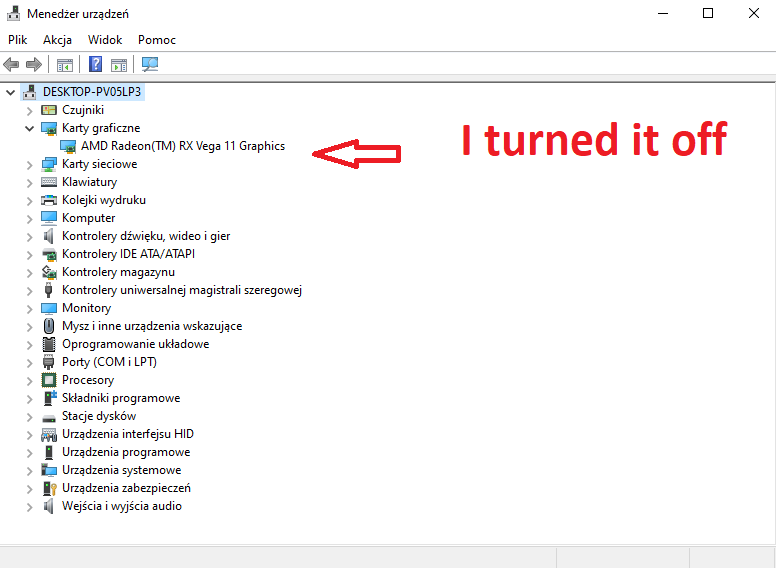

In one day something was changed in the Fusion 360 Electronic. It cause the problem in display schematics and PCB window in Fusion. When I open schematics or PCB I only see black screen.  The problem is with my display card Radeon RX Vega 11. When I turn it off in devices manager I can see schematics and PCB window. Yesterday I was able to work with schematics/PCB.

Uncheck "Enable GPU rendering" fix the problem.
