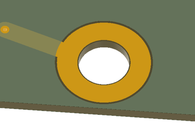

I've made progress.
I'll have to ensure the board manufacturing can handle this and ensure the second surface component on the other side of the board works. I didn't like the polygon as it was being difficult to manage the desired shape.
I created a surface mount pad with a single pin and a npth place at the center on one new custom library component...
I've attached the top and bottom 3d view the top side component.
I'm thinking if I create another separate component that is simply a surface pad and pin without the hole... Will this work, no idea yet, but as a surface mount there should hopefully be no constraints and I'll have the desired outcome.
Being able to deselect the pth and change it to a npth should would be helpful as a via or something else directly and not have to go through all this trickery or allow a drill at a via and not block it.

Hi @pstamand,
I hope you're doing well. Could you post a picture of what you are seeing in the 2D PCB? At the end of the day the source of truth is the 2D PCB so if everything looks good there it is good.

pstamand
I did its attached as 2 png files.
Message 6 of 19
pstamand
Ah, I posted 3d, here also the 2d top and bottom
I  still need to add the surface component to the bottom side, but as surface the pads shouldnt matter.  I have no idea what the hole in the top side custom component will do on the bottom side, my desire is as  surface the bottom wont care about the top side hole.  for manufacturing as long as the hole happens last, I'll achieve the desired outcome.

Hi @pstamand,
I hope you're doing well. Unfortunately, I don't think this will work. One of the last steps in PCB assembly is plating if it's not specified that the hole shouldn't be plated then I think it's still going to plate through.
Here's another idea. In the library put a single hole then at the north-south-east-west positions and at the device level make sure they all connect to the same pin. Do this on top and bottom. When you press fit the nut it will make contact with at a least one of those 4 pads. If you really want to guarantee the connection you can add more pads (6 or 8). This might be the easiest way to proceed.
Best Regards,
Jorge Garcia

pstamand
ignore the trace widths,  I took another approach to separate the hole and place a large pad with a single pin in it...
Is the hash in the VCC pin indicating a concern or normal...
Fusion wont let me put a wide trace into the pad and it goes beyond a tangent to the pin, which is understandable.  I can certainly add addition common pins to create more connection points if that's an option.

Hi @pstamand,
I hope you're doing well. I think this will work, the DRC is reporting violations but from a manufacturing standpoint this will work. If you want the bolt to be able to connect, make sure to expose the copper by covering the copper in tStop and bStop.
Let me know if there's anything else I can do for you.
Best Regards,
Jorge Garcia
