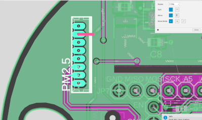

Moving while preserving angles
By default, when moving anything in the PCB workspace, Fusion will maintain the connections and the angles at which those were made. This way, edits can be very quickly made without introducing a bunch of re-work. However, for large do-over move operations, this could be unnecessary effort. To turn this option off, check out the “move mode” in the MOVE command dialog. Note that this setting also affects other commands that execute a move, like the ALIGN command.
