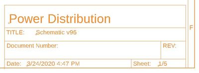

rbeyerCLBSZ
Yes, however that adds even more confusion...
The title blocks automatically add the "Internal Version" number to the schematic name, so they end up looking like this (please note that the design is named "Schematic" in this case, I did not add the "v95"):
What you are proposing is to name it "Schematic V1", but then on all title blocks it shows up as "Schematic V1 v95".
I just honestly don't think that the "internal version number" should be displayed at all, or keep them in sync between the files meaning that they should all be at the same version number, all the time. Even from an internal point of view, when trying to recover old work I'm not entirely sure (until I run DRC) that Schematic V95 refers to Board v86 and Design V91.
I think Autodesk is trying to shove the mechanical version system into the electronics design one and it just doesn't work. No other software works this way on the market. Even Eagle was fine in this regard!
