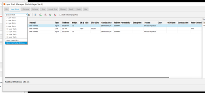

Hi Mike,
This is not very difficult to achieve. I have made a layer stackup preset for you named: Mike.Durian.CustomStack.estackup.zip (you need to un-zip it before using). You can load the preset by using the layer stackups drop-down box to teh left of the Layer Stack dialog, please see pictures below:
After loading the layer stack preset following the steps shown in the 3 pictures above you can update the layer stack as required by using the Right Mouse Button context menu that allows you to add / delete layers including Silk Screen, Solder Mask, Surface Finish, Pre-Preg. etc. You can also change layer material properties by toggling on the "Edit material properties" check-box:
If you make changes you can save them by using the Save button to the right of the Layer Stack preset drop-down box, please see picture below:
The easiest way to start customizing a layer stack is by starting with one of the provided presets that you can pick from the drop-down box. When you start a new design that will have 2 signal layers the "2 Layer Stack" will be selected. You can change to any of the existing simetrical setups for 2, 4, 6,.., 16 layers adn then customize to make it your own.
The other way is to use one of the Eagle layer setups, for your setup is this: ([2:1+(2*15)+16:15]). You can load it by selecting the "Open From Setup String..." command as shown below:
In the subsequent dialog:
Insert you layer setup string click Apply and the layer stack will be populated with the right setup. Then you can adjsut it using the Right Mouse Click context menu commands:
and if you want to change layer material properties locally then check the Edit material properties check-box and the layer stack grid cells will become editable.

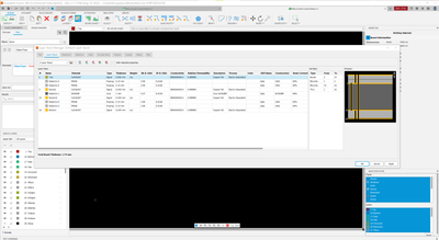

mike.durian
Hi Constantin,
This initial stackup you sent was fine. However, I want to learn how to do this instead of just use one you provide. That way I'll be able to create other stackups as I need them. It's the whole give a man a fish vs teach a man to fish thing.
In the image below, I used the buttons circled in red to create a new layer pair. I do not need to disable symmetry as I want to create the signal/prepreg layer pairs in pairs. Ugly wording there. Let's just say I wanted to create both L2 and L15, knowing that creating a signal layer will also create an associated prepreg layer.
That created the layers circled in green. Both a prepreg and signal layer were created. This is fine and expected.
What I want to learn is how to flip the prepreg/signal pair such that the prepreg is above the signal, not below it (for L2, for L15 it would be the other way around). By default it is creating the signal layer farther from the core than the prepreg. I want prepreg father from the core (for L2 and L15, not L1 and L16).
I'm sure I could easily do this by editing the XML, but I'd like to learn how to do it through the UI. Can you please explain how I can do this?

constantin.popescuXD3CL
Hi Mike,
The easiest way to achieve this is to 1st remove the 2 Pre-pregs that are incapsulating the Core layer and then Right Click on the Route2 and select Insert Above and choose the only available option which is Pre-Preg, then do the same for Route15 but select Insert Below and choose the Pre-Preg. The reason for which you need to remove the 2 extra pre-pregs is that we don't currently have commands to move them up or down. We'll look into adding them in the future if the current supported commands are not sufficient.
I understnd that you want to learn how to use it and that's great, I just wanted to give you head start with your current issue. I have built that layer stack completely by using the UI I haven't touched the Xml file at all so everything should be possible right there.
Please let me know if this still doesn't answer your question and I'll try again. Good luck.
