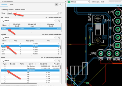

I am trying to add stitching vias to a PCB. I added them once then thought I deleted them as they no longer show up in the layout. However, when I try to add the stitching vias again I get an error...
Error: Via stitching conflicts with existing stitches on the board. Adjust the stitching area to prevent overlap.
So it appears those previous stitching vias may still be there somewhere? But how to view/delete/edit previously added stitching? I don't see a layer for it, nor anything else in the design manager that would indicate the stitching is still there.

Hi @wayneweeks ,
first question: Do you have layer 18 Vias active? If it is not displayed, you won't see the vias and the stitch contour.
If you do not see the via stitch, you could use the Design Manager panel to locate it.
In the Design Manager's browser tab, chose Signals view, select the net class and the signal that might have the via stitch. In the items list you will see an stitch icon. Select it and a pointer will show you in the layout.
Now you could delete the stitch as a whole by clicking the contour of the array with Shift + DELETE.
As an alternative you could use the Selection filter. Chose Via Stitching and draw a rectangle all over the board area. All stitches can be deleted now.
Just let me add another way to locate stitches: You could use the Design Manager's Filter funtion as well.
In the image below I selectes the Filter tab and search for an object type Via Stitching.
I found a stitch in the GND signal.....  🙂
I hope this helps.
