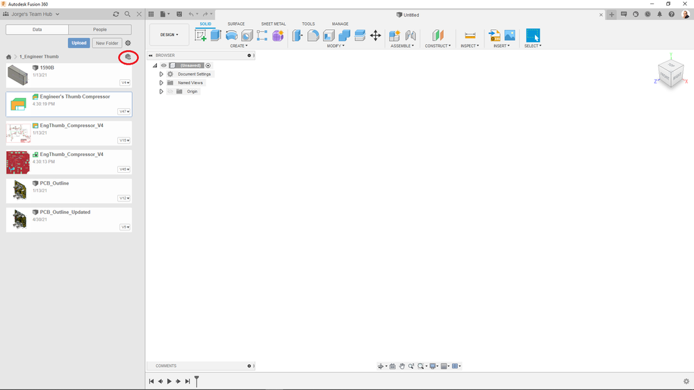

With that said, you may be able to achieve what you want by viewing the hub on the web. Go into the project in Fusion 360 and then click the view on Web icon(bottom picture). Find the file you wish to move and the click on the arrow that points down. You'll see the option to move the file to other projects within your hub(top picture).
