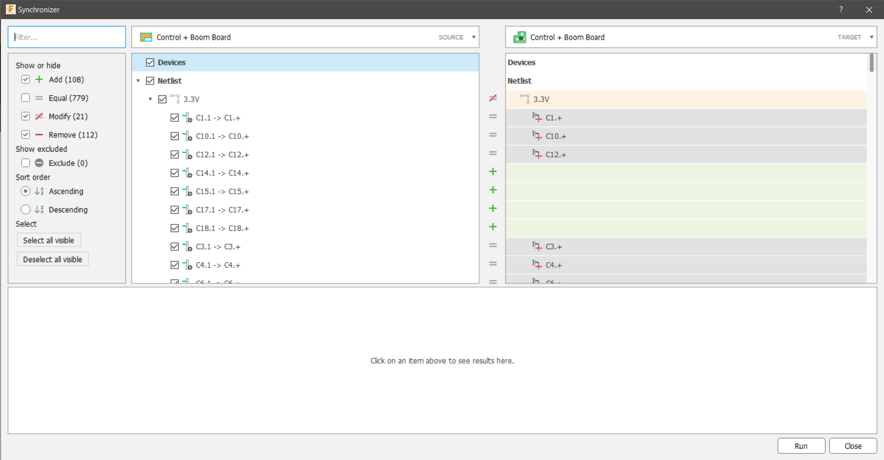

I am having a rough time trying to combine two Schematics/PCB's I have been working on at work. They were going to be separate boards but we have more space than expected and we decided to put it all on the same board, I just need to "copy/paste" them together with some minor edits. Panelizing them is not acceptable as they need traces going from one to another (which were previously terminal blocks and wires.)
Copy/pasting the components from one schematic to another "works," but then I'll have to redo the layout of all those components on the PCB, which is obviously unideal. After some googling, I have tried creating a separate Electronics Design, create a new PCB, copy/paste the layouts from both into it, then link it to a schematic with their schematics on different sheets. This should work, expect I get the error "Schematic/PCB sync deactivated: Run ERC to find differences and resolve them." Clicking on this shows the "ERC Errors" window (attached), and clicking on Synchronizer, then Run, also yields no results, just removes half of the traces.
Any help would be much appreciated. Thanks.

Hello @bostonK74CU,
as you can see in the ERC-Dialog, al lot of parts are connected to the "wrong" net.
You can solve this by renaming the nets "GND1", "3.3V1" and so on to the desired net-name.
You can do this in schematic or in layout.
Try to identify net "GND1" and change its name to "GND". The next "ERC" schould show less errors.
Some earlier days, the "ERC" generated a text-file, where you found all ERC-errors, so someone would be able to solve the ERC-errors step by step with the text-file.
No fear, if you do this step by step, your problem can be solved in only a few minutes.
I think this way is much easier than generating design blocks.

bostonK74CU
@m.neujahr_at_moe
I tried that, and it seems that the ERC is adding the "1" to the end of GND by itself. On both sheets the value for the GNDx symbols read "GND." However, in the ERC dialog box is shows GND for sheet 1 and GND1 for sheet 2. Very odd.
