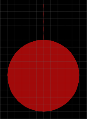

I tried following the instructions for making a circular and loop polygon. Results are below.
Radius = 10mm
Center = 40,40
Here are my coordinates
      1           2           3            4           1
(30 40)(40 50)(50 40)(40 30)(30 40);
The result: (not a circle)
chuck_toddN7PTC_1-1749044540827.png\
Loop of width 5mm.
Coordinates:
       1           2           3          4           5           6          7            8          9          10          1
(40 50)(40 45)(35 40)(40 35)(45 40)(40 45)(40 50)(50 40)(40 30)(30 40)(40 50);
Result: (not a loop)
What am I doing wrong?
BR -Chuck

Message 4 of 12
jorge_garcia
Hi @chuck_toddN7PTC ,
You didn't do anything wrong, the segments of the polygon that are concave if you click on them you'll see that the inspector shows a property that says angle or curve. What ever number is there make it negative. You'll see the curve change and now go the correct way.
Let me know if there's anything else I can do for you.
Best Regards,
Jorge Garcia

Message 7 of 12
chuck_toddN7PTC
@jorge_garcia
I provided my attempt at a loop in my first post. I'm assuming that the process of entering the coordinates is as follows.
Loop of width 5mm.
Coordinates:
       1           2           3          4           5           6          7            8          9          10          11
BR -Chuck

Message 8 of 12
jorge_garcia
Hi Chuck,
Sorry about that, I should have read more carefully. OK so the trick here is in the image the red and green edges cannot line up exactly. They need to overlap by a little so at point 6 add a small offset (39.99 44.99) and at point 7 add the same offset (39.99 49.99). From there continue with the rest of the points.
That should give you the result you want. I also tried it with the offset in the other direction leaving a small gap.
Let me know if you continue to run into problems.
Best Regards,
Jorge Garcia

chuck_toddN7PTC
@jorge_garcia
Thanks for the help. The instructions are not very intuitive. This information is good to know, may come in handy some day.
Loop of width 5mm.
Coordinates:
(40 50)(40 45)(35 40)(40 35)(45 40)(39.99 44.99)(39.99 49.99)(50 40)(40 30)(30 40)(40 50);
Grid = 1mm
BR -Chuck
