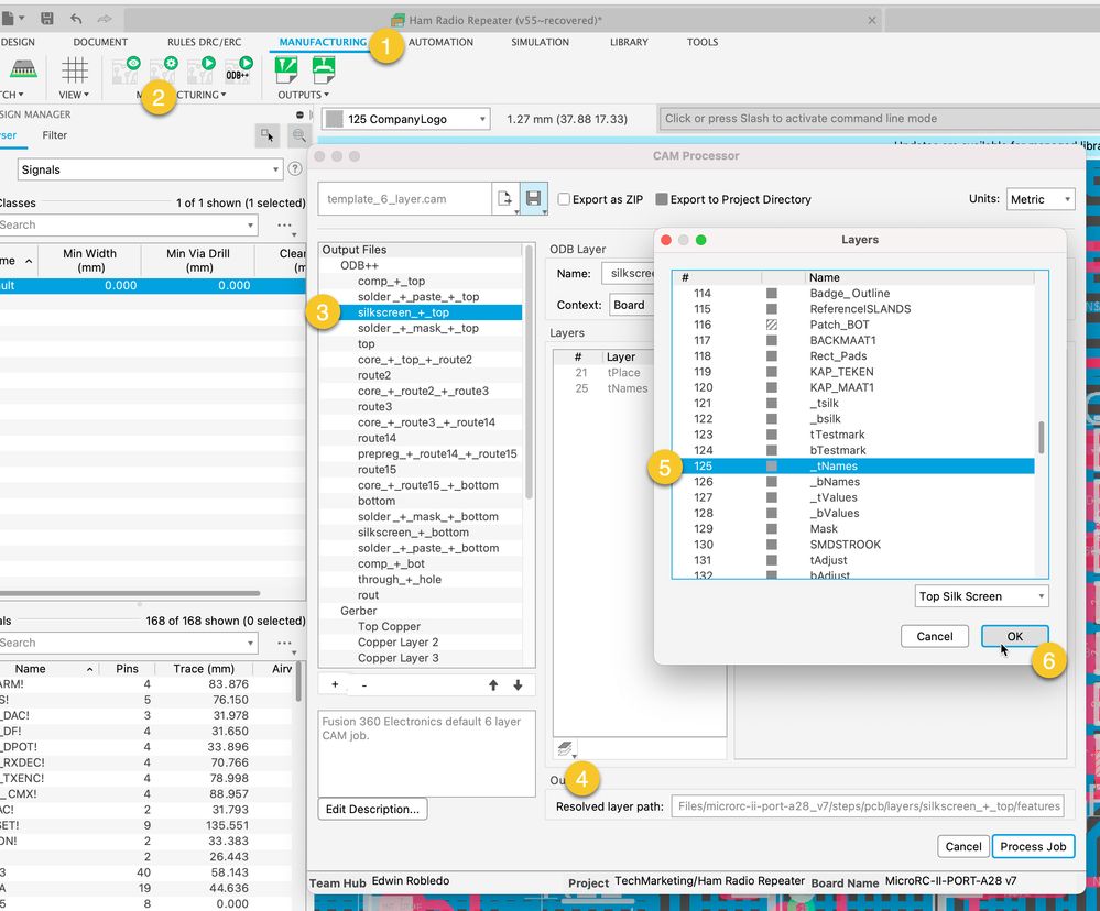

Hey @mario.brizida - I was able to get a response from Edwin, who sent these instructions for configuring Layer 125. Also we are grateful for your feedback so we can keep in mind when updating our documentation:
"Updating in the CAM processor is fairly easy if you know how to do it.  It’s a step that is not really obvious.
1 + 2: From the manufacturing Tab select the CAM Processor
3: From the ODB++ group, select the section you want to edit the layers
4: At the bottom of the ODB++ layers, use + and – to add or remove layers.
5: If adding layers, select them from this dialog box.
6: After selecting the layers press OK to complete.
