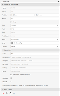

Here is all that there is on my 'INSPECTOR' when I choose to rotate/spin the name 'V2' of a connector:
Changing the value for 'Angel' has the same behavior than clicking on the semi circle/ round arrow on the very bottom.

jorge_garcia
Hello @Musti75,
I hope you're doing well. Are you looking in the schematic or in the board? The Spin flag is only available in the 2D PCB, it's not used in the schematic.
Let me know if there's anything else I can do for you.
Best Regards,
Jorge Garcia
