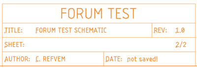

I'll go through the general process and try to reproduce the issue:
  1. First, I open a new schematic and add the custom frame (Library attached for your inspection). At this point there are no attributes in the frame or in the document.
  2. Then I will add attributes to the document to fill in the title block.
  3. At this point I would expect the frame to update properly, but I see the following; note that the revision number is not displayed even after forcing the screen to update/redraw.

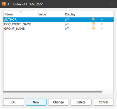

    If I look at the component attributes I see that some of them copied over, but not all of them
  4. I can then fix things by right-clicking on the frame and choosing "restore position", which will then render the docfield properly.
    After doing so, the attributes of the document now are mostly updated in the attributes of the frame. I believe the icons on the right are meant to show whether they're document or component attributes, but they're unlabeled and confusing to me (I've highlighted what I mean).
  5. Almost all my projects have multiple sheets on them and I'll usually make a second sheet and then copy over the frame. On the newly created sheet, only some of the attributes come over. I think these are the ones still referenced globally but they show up with no value and my docfield on the second sheet is not displayed properly.
  6. At this point the way to fix the problem is to delete all the attributes in the copied frame, and then do another "restore position" from the right-click menu.
