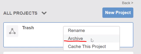

In this case, I'd suggest you create a trash project -> Move the break linked 3D PCB file into the trash project -> Right click project -> Archive it.

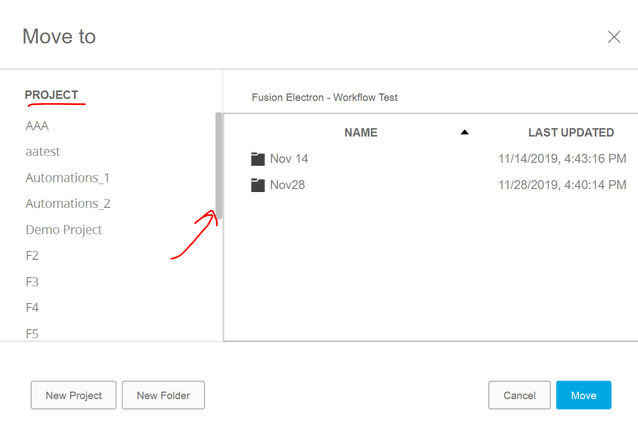

Hi @relaxmax01 ,
Did you notice there is scrollbar in the Move to dialog which will allow you to select the project under your current hub?
You are only able to move the file to another project in the same Hub, but cannot cross Hub.

relaxmax01
Hi Helen,
I'm not sure what Hub is; but no I don't have a project scrollbar in my move option (by right click any file on the left in data panel --> Move).
I created a dummy design (just a plain box, no dependencies) and same result, the Move dialog box does not show an option to move across project as in the screenshot above.

It turns out that my project where not part of a Fusion Teams but in personal storage. Once migrating all my projects to a Fusion Teams, I'm able to move those files in the dummy Trash project as suggested by Helen and archive it.
