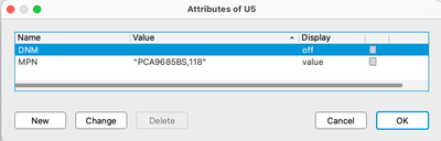

I have a part, containing a comma in the part number.
When we export the BOM, the CSV is essentially broken, as there is an additional comma in the MPN, that offsets all fields afterward.
We tried a workaround by adding quotes around the MPN, but these somehow did not end up being included in the CSV either. For our MPN attribute.
See the MPN field in the example below:
,Qty,Value,Device,Package,Parts,Description,ASSEMBLY_NAME,BOARD_NUMBER,BOARD_VERSION,BREAKDOWN_VOLTAGE,CAPACITANCE,COLOR,DESCRIPTION,DIELECTRIC,DNM,FORWARD_VOLTAGE,HEIGHT,MANUFACTURER,MANUFACTURER_NAME,MOUSER_PART_NUMBER,MOUSER_PRICE-STOCK,MPN,NOBOM,NOPNP,PART_NUMBER,POWER_RATING,RATED_CURRENT,RATED_DRAIN_CURRENT,RATED_DRAIN_SOURCE_VOLTAGE,RATED_GATE_SOURCE_VOLTAGE,RATED_POWER,RATED_REVERSE_VOLTAGE,RATED_VOLTAGE,RATET_VOLTAGE,RESISTANCE,REVERSE_STAND_OFF_VOLTAGE,SPICEPREFIX,TOLERANCE,TYPE,VGS_TH,VOLTAGE_IN,VOLTAGE_OUT,VOLTAGE_RATING,WORKING_VOLTAGE
44,1,"PCA9685BS,118","PCA9685BS,118",QFN65P600X600X100-29N,U5,"PCA9685 - 16-channel, 12-bit PWM Fm+ I2C-bus LED controller",,,,,,,,,,,,,,,,PCA9685BS,,,,,,,,,,,,,,,,,,,,,,
When exporting the BOM from the schematic view, Output -> Bill of Materials, we get quotes around all fields, which is good. However, our MPN with commas, now has two sets of quotes in the CSV (the one we added, and the one added by the exporter).
