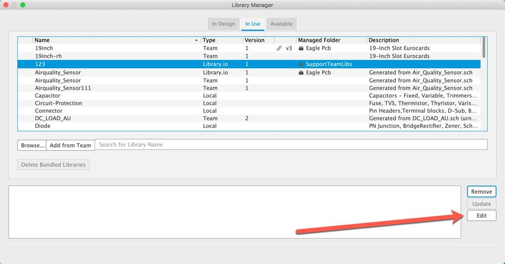

Up to now I worked with standalone EAGLE electronic design. I created a lot of private shared libs but in FUSION360 I can use them but I am not able to modify the contents as I did with EAGLE. Is there another workflow? What I realised is that I receive readonly libs which they should not be because that are my private libs and should be available.
How can I work with my preworked libs. In EAGLE I start edit and change or add parts and create a new version of the libs.
Regards, Harald
Message 14 of 37
RichardHammerl
Hi @HarrySatt ,
so you are working with libraries coming from library.io (your EAGLE libraries), correct.
It is possible to edit them. The easiest way would be to open the Library Manager and go to the In Use tab. Now select the library you want to edit and click the Edit button.
The library editor will open and then you can edit.
Hope this helps.
Regards,
Richard Hammerl
