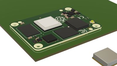

jroddisRT8HL
Create a new device for the module in your library.
Footprint -> Footprint of the module.
Package -> .step of the module, making sure it is above PCB height.
I did this with a Pi CM4 and it works quite well:
Is this what you mean?
CaptainMJ
@panpan_fan , @jroddisRT8HL  Many thanks for your suggestions, the both work great, much appreciated!
