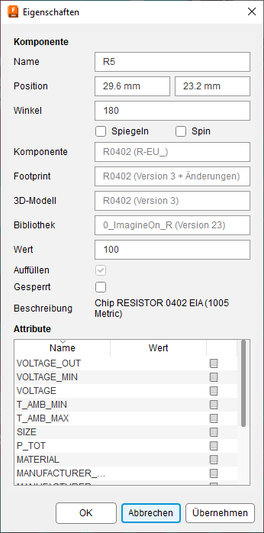

Just wanted to let you know, that there can be different outcomes with the same Library.
R5, R13 and R14 are all 0402 Resistors. They were from the standard rcl Library and looked like the 0402 Capacitor C8 in the Picture.
I replaced R5 with my own design and outputted it to 3D to check if everything was correct.
After that was confirmed, I replaced R13 and R14 too, but when I rendered again, they were tilted.
How can this be? I am using the same Library for all 3 resistors, but I get different results.
Thanks for reading!

Thanks for the post.  Can you tell me the rotation angle of each of those parts in PCB (the 2D rotation in the 2D board editor)?  ie - is there any chance you can screen show the properties of the parts that display at the right rotation and the others that do not?  Thank you.

First the Angles:
Right:
R5 = 180°
(C8 = 270°)
Wrong:
R4 = 90°
R13 = 270°
R14 = 90°
Right:
Wrong:

We have identified the reproducible steps about 3D PCB design mess up issue and the key point is the OS region is French, Dutch, Norway or others which might have format differences.
Before this issue is fixed, the workaround is:
  1. Change the OS region to English instead from French, Dutch
  2. Break link for the problematic 3D PCB
  3. Push to 3D PCB again
Please kindly try the workaround before this issue is fixed.
