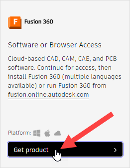

Hi @steven.craw I'm sorry you are running into some issues. I know Autodesk takes education extremely seriously and knows they are important. That is one of the reasons they provide all of their software to the education sector at no cost.
Once the verification process is complete, students and educators still need to access the license to activate it. Here are some steps for how to do that. If you continue to run into issues after these steps, please follow up here and we will do our best to get you up and running as quickly as possible.
Kevin
  1. Go to Autodesk Education site and sign in with your Autodesk credentials.
  2. On the Individual tab, on the Fusion 360 product card click "Get product".
  1. Click on "ACCESS".
  1. Launch Fusion 360 (if you're running Fusion from a browser, you can cancel the install).
  2. If the Education license does not appear on the top of Fusion's screen as shown in the following image, sign out and back into Fusion 360.

Hi @steven.craw
Thanks for adding your feedback. The installation of Fusion is not required. To acquire an education license of Fusion you must click on Get product from the Fusion card and then click Access. If Fusion is already installed, you can stop the installation. Here are the step to acquire a Fusion Education license.
  1. Create or renew your Autodesk Account and Education Profile in the Chrome browser - Incognito window in preferred.
    Note: If you're renewing your Autodesk Education eligibility, you must also renew your Fusion Education license by following steps 3 - 7.
  2. Go to Autodesk Education site and sign in with your Autodesk credentials.
  3. On the Individual tab, on the Fusion 360 product card click "Get product".
