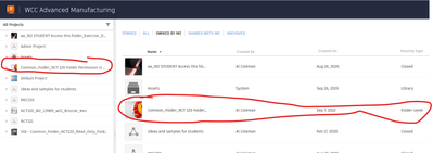

acoleman10
I am having same issue as others posting here. I can toggle individually or multi-select and it shows Reader until I hit refresh. They revert back to viewer. Status doesn't seem to affect anything. I have one co-instructor that is a project  contributor and his reverts to viewer as well.
Ideas beyond what has been recommended above?
Message 15 of 32
dan.banach
Hi @acoleman10
Can you tell us what your folder structure looks like? If you have subfolders that you are trying to changes Roles in, ensure that no Role assigned to the parent folder. A subfolders will have the same Role as the parent folder and this can’t be changed.

acoleman10
I believe it is a top level folder.
Message 17 of 32
acoleman10
@dan.banach
Hi Dan,
I believe this is a top level folder.
Message 18 of 32
dan.banach
Hi @acoleman10
Thanks for the screen capture. This shows that your Common_Folder project is a Folder-Level Project. To see the folder structure, in the middle pane, double-click on the Common_Folder project. Then ensure no roles are assigned to a parent folder where subfolders will have different roles. A screen capture of the folders will help that shows the roles.
