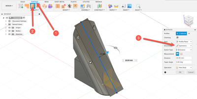

Hi @contactR9VDY Thank you so much for that image. It was very helpful for me. That was the surface I was referring to as the more complex one that you can't just place a tangent plane. Here is how I went about this.
Create a sketch on the plane as shown
Next click the Slice ption in the sketch palette
From the Create menu, choose Project / Include --> Intersect. I then selected these points shown in magenta with the red arrows pointing at them
Next draw a line from point to point. Then you can finish your sketch.
Switch to the Surface tab and extrude that line using the symmetric direction option. This will create a surface body that will be planar. You can extrude it as much or as little as you like. This is just going to be used as a sketching plane.
Place a sketch on that plane and draw your shape
Then you can extrude your shape. Note that you may have to make sure the Operation Type is set to cut
Let me know how that part works out for you and if you have any questions.

That's amazing! That was exactly what I was looking for!
Thanks a lot!
