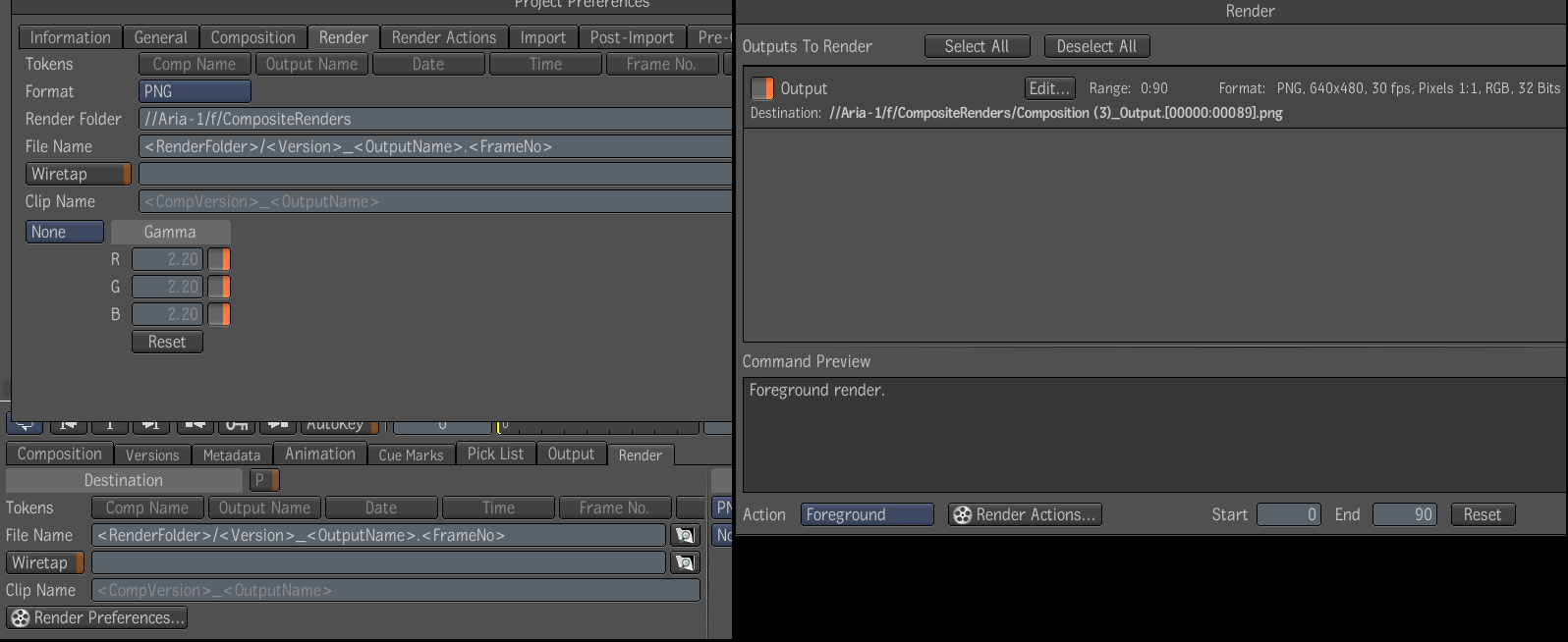

Steve_Curley
Hmm...
I just tried it and it worked 1st time.
Selected the Output node then the render tab.
Opened the Project Preferences and changed just the Render Folder entry to "//Aria-1/F/CompositeRenders" and OK'd the dialog.
The FileName I left as "<RenderFolder>/<Version>_<OutputName>.<FrameNo>". File > Render and at the top it showed the full expanded file name (correctly) - clicked Start and it worked.
If it's not working there then I would suspect a permissions problem, or you somehow didn't manage to get the paths changed properly.

miketruly
Thanks again Steve!
Touchy is a bit of an understatement.
The imported footage works fine using UNC paths.
I was able to get the writing of rendered frames to work by putting this in the Output>Render>Filename slot (per your screenshot... how would I have known to use <RenderFolder> given that it's not one of the button options?):
<RenderFolder>/<Outputname>.<FrameNo>
If I instead use:
<RenderFolder><Outputname>.<FrameNo>  (without the forward slash)
Composite crashes the second I try to open the Render dialog.
It's a real shame that the code is so flaky that a simple incorrect path syntax can crash the program.

miketruly
Attached is a screenshot showing both the path setup in the Project Preferences>Render>Filename slot and the path as setup in the Output>Render>Filename slot.
The preferences filename slot has no forward slash in it and seems to work fine.  The Output render filename slot must have the forward slash or it crashes Composite2014 when trying to open the Render dialog.
I'm a bit confused as to why there is a Filename slot in the preferences if it will be specified in the Output>Render>Filename anyway.

PiXeL_MoNKeY
[quote]I'm a bit confused as to why there is a Filename slot in the preferences if it will be specified in the Output>Render>Filename anyway.[/quote]The Preference Value is what is used for any newly created output nodes, and is carried over between projects. The filename in the output node can be changed.
