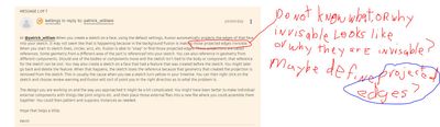

kellings
Hi @patrick_william When you create a sketch on a face, using the default settings, Fusion automatically projects the edges of that face into your sketch. It may not seem like that is happening because in the background Fusion is making those projected edges invisible. When you start to sketch lines, circles, arcs, etc. Fusion is able to "snap" or find those projected edges. Those projections are called references. Some geometry from a different area of the part is referenced into your sketch. You can also reference in geometry from different components. Should one of the bodies or components move and the sketch isn't tied to the body or component, that reference for the sketch can be lost. You may also create a sketch on a face that had a feature that was created before the sketch. You might later go back and delete the feature. When that happens, the sketch loses the reference because that geometry that created the projection is removed from the sketch. This is usually the cause when you see a sketch turn yellow in your timeline. You can then right click on the sketch and choose review warning and Fusion will sort of point you in the right direction as to what the problem is.

patrick_william
Thank you Kevin for replying.  I need some of the definitions explained in order to understand the concept. I don't know what a "projected edge" looks like or what that means. I am importing organic shaped svg files that do not have the geometry simple like a circle or square or straight line. can you explain it in terms of what fusion does with organic imported sketches?
