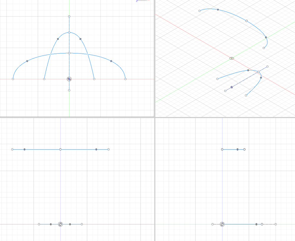

Given two curved lines in parallel planes, and flat sheet (for example paper or 1 mm veneer in my case), I need to wrap that sheet around those curved lines. Sheet wrapping without creases forces constraint that distance on surface between any two points remains the same in plain and wrapped surface.
Loft can be used to make surface that connects those lines, (I tried some options as beginner) but loft creates surface that can't be made from sheet of paper because loft surface violates sheet wrapping constraint that distance on surface between any two points remains the same in plain and wrapped surface. If you look at surface generated with Loft from front (left upper corner below), then you can see curved silhouette on sides, which should be straight if it could be made from sheet of paper.
To be sure I printed surface on 3D printer and used paper sheet to wrap it around such lines, and it can be done for sure. Red line below to show curved silhouette which is wrong, green line shows that wrapped sheet create stright sillhouette line.
Could anybody suggest best way or best workaround how to achieve such kind of sheet wrapping around two curved lines in Fusion 360?

You could try adding a couple more guide rails between the curves to eliminate any compound curve.

I found correct terminology - I'm looking for developable surface or ruled surface feature in Fusion 360. I'm looking whether there is a way how to automatically make such surface between two curved lines in Fusion 360.
I suspect it is not possible manually calculate / make correct guard rails for loft that would result in developable or ruled surface.

TheCADWhisperer
You can UnWrap your surface in free Autodesk Meshmixer and then bring back into Fusion 360.

I understand that there are limitation to sheet metall in Fusion 360. My use case with bent plywood starts from splines on end form (minimal constrains) and then creating developable surface between them. So, to rephrase my question:
Given curved lines on both ends of 'C' or 'O' like surface, does loft (with connected profile types) creates developable surface (which exists for sure).
As understand correctly, developable surface should have zero Gaussian curvature, which unfortunatelly is not the case:
I guess I answered my question - loft feature in Fusion 360 doesn't create developable surfaces. It is possible to do that with Autodesk Inventor Professional and its Lofted Flange sheet metal functionality.
Any workarounds or creative ideas with Fussion 360 or other tools? Probably guide rails for loft, but I can't imagine how to manually calculate them, so not really an option for parametrized design.

I don't think with plywood your tolerances are going to be so tight that you can't get a good enough flat pattern (Unwrap) washing through Meshmixer.  It is really very easy to go through Meshmixer and back to Fusion.
Bottom line, you are not going to get a Flat Pattern in the current version of Fusion 360.
