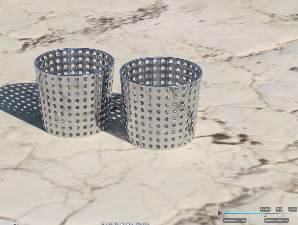

Here's a file that's a good test for modeling and rendering. If you import and run a compute all Ctrl+B the fillet rule will give you a good test, on my 2.4ghz i7 note book it takes about 3 minutes for a single component. Note only 18% utilisation and speed 3.36Ghz. I have read on the forum that Fusion is supposed to use multiple cores if you have independent components that don't have any references to other components but testing with 2 of the components in the attached file it looks like Fusion is just running the timeline in sequence so 3 minutes for one component and 6 for 2!
@ryan.kelly155 It will be an interesting test of your Ryzen PC in the render workspace as all cores are used so it would be interesting to see how your i7 and Ryzen PCs compare. An in canvas render just to the Excellent setting took 1228 seconds, just over 20 minutes.

@HughesToolingSo I have only tested the render time so far, took about 330 seconds to get to excellent, rendering pegged all 16 threads which was the first time I did that. unmodified CPU got up to 58 degrees Celsius and stayed there with a pretty run of the mill air cooler, (evo 212) I have a large liquid cooler radiator in the mail which I plan on overclocking the Ryzen with, hopefully I can get the speeds down even further then Capture.PNG

Just checked the force rebuild time and its pretty much the same as your stated time, ~ 3 min for 1 and 6 min for 2... I wonder what the bottleneck there is, my CPU and GPU both were barely trying but fusion stopped responding multiple times

Not all algorithms in Fusion 360 lend themselves to be parallelized and hyper threaded.
Rendering algorithms can be very much parallelized and thus uses all possible processor power on multicore machines.

In another thread looking for advice on a new computer I recommend going for a more GHz over cores and someone wanted to argue that Fusion would multithread and use all cores. It's pretty well know that CAD is not good at paralyzation so I made this part to show the problem, you can't start adding the fillets before the holes are added.Smiley Happy Also adding the fillets can only be done by one process because each one modifies the body and some surfaces disappear.
Unless you're doing a lot of rendering of CAM work I'd still recommend going for the fastest processor, your Ryzen is pretty impressive almost 4 times faster with only twice as many cores.
