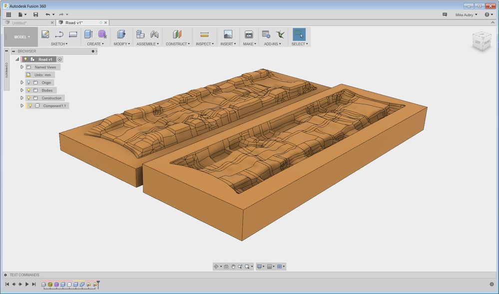

I think the issue you've been having coming from Recap to Fusion might be this: are your default mesh settings set to triangulate mesh?   If so, (and we need to change this btw as being the default) please kill it:
The forum post on the Recap site discusses
If your conversions errors are this then I bet that's the issue:
I've attached the file I've had success with.  With the complexity of the surfaces I don't think you'll have success with draft or shell, but that STL for sure is something we can at least convert. The example I've created shows great potential just using combine.
