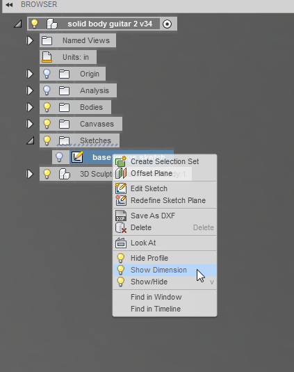

  2. Regarding:  "It would help if we could have an actual "dimension" layer or something within the Modeling mode. You have to keep going back to Sketch mode to read the measurements":  While Fusion doesn't have a dimension layer or 3D annotations yet, you can turn on sketch dimensions so that you can see them without editing the sketch:
Good luck with your designs!
Jeff

Ha! Learning something new every day. That's extactly what I had in mind. Thanks Jeff!
