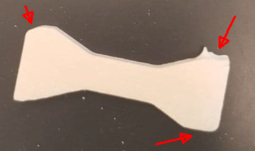

I've designed a flat-dog-bone-shaped specimen in Fusion 360 to generate a G-code for the CNC mill. when I run the simulation both on Fusion360 and on my CNC machine everything looks fine but when I run the real simulation it gives me the following specimen:
what I designed is as follows:
So as you see, 2 of 4 edges have not been milled properly. I was wondering to ask if anyone can help me solve this problem. I guess there is a tool compensation parameter that I missed and I don't know how to account for that. I have attached my .f3d file as well. I'd really appreciate your advice.

Is this the correct file? It looks like the one I helped you with the correct way to select the whole profile. Also working from a mesh is not really a good idea and will not create a nice toolpath of simple arcs and lines.

You have the op set to In Computer so the path is offset so no compensation needed in the control. You did use the same size cutter on the machine as you set in Fusion?
This should have worked but what control does your CNC have? Because you worked from a mesh the G Code will have lots of short moves, some arc some lines. Some controls can have problems if there are lots of arc moves like this. Best if you can redraw in Fusion as a proper solid model then try again.

@firanman  It dawned on my the part might have moved when it cut through. I see you'd enabled tabs but the distance was too big so you didn't have any!
I've edited the operation and set to At Points and select the midpoint at each end. I've also set the lead to ramp so it's not plunging in. What material thickness are you cutting the part from, you've set the stock to 4mm in the setup. This will need to be correct for the tabs to work. See attached file.

It looks like the part has moved because the stock thickness was probably wrong so it cut through the tabs.
I've made a screencast fixing your second model and set the bottom depth to Stock Bottom -1mm, make sure this matches your stock thickness.
Your sketch is not done well, you've drawn it at a random place rather than fixed to the origin also you should not draw fillets in the sketch as it's easer to constrain and dimension with sharp corners. Design's attached.

The reason for the tabs is you need to hold the part in place when the cutter takes the last cut around the part. I'm pretty sure the problems you had with missing corners on the finished part was because it moved.

What machine and control are you using and have you got the correct postprocessor? Even if you used the wrong cutter it should still be consistent, all corners should be the same. A wrong sized cutter would only make the part the wrong size.
Different CNC controls can specify circles and arcs differently so you need to make sure your postprocessor and control are set the same.
Try the attached file. I've modified it so there are no arcs on the part or in the toolpath.
