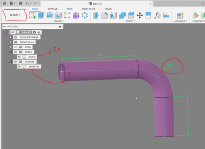

Part of my model consists of a rail made of bent tubing. I've created a 2D drawing and tried to give dimensions etc with reference to the centrelines of the tubing. The centreline tool works fine for the straight bits but doesn't work at all for the bent bits, so I've used the sketch tool to create centreline arcs that start and end orthogonally to the straight bits.
Linear dimensions to the 'proper' centrelines work fine, but the arc radii don't match the dimensions.

I figured it out (well actually my son did) - the drawing was scaled 1:2 but the sketch isn't scaled at all. In fact, it doesn't seem possible to scale a sketch - which is rather surprising. How can I dimension the centreline of an arc? There is no tool to draw the centreline of an arc so the only alternative is the sketch facility, but I can't figure out how to scale a sketch. Any takers?
Message 3 of 13
laughingcreek
you can create a sketch of that center line in the design workspace, and then expose it in a drawing.  I think it has to be a regular line, not a construction line, but it will display as a dashed line type in drawings.

laughingcreek

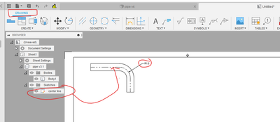

after reading the other replies i'm wondering if I miss-understood your question.  I'm assuming you drew the your "center lines"  while in the drawings environment, using the rudimentary drawing tools there.
if not, disregard any of my replies.
if so-
-there isn't a scale setting for an entire drawing, each individual model view has it's own scale setting.  lines draw in the drawings environment aren't associated with a model view, so don't have a particular "scale."
-the "center line type" in drawing views is just referring to how it looks (continuous, dashed, etc.), not it's function.  still just a "dumb line"
-create a sketch in the design environment (in this pic I made a sketch and then used pipe command)
when you make your drawing, toggle the sketch on-
Message 9 of 13

laughingcreek
maybe this is clearer-

Message 13 of 13
lemelman
Thank you, that was much clearer and solved the problem completely.
I didn't know you could include a design sketch into a drawing.
