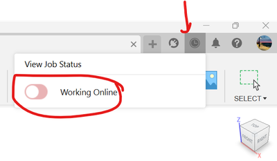

@tranq006, Would you please try below two things in your side and see if the performance can be improved?
  1. Change Fusion into Offline mode
  2. Disable High-resolution canvas graphics on high DPI display from Preferences->Graphics->Display.
-Lisa
Message 16 of 62
tranq006
Still have same issue, it most often occurs when hitting escape key within a sketch
Message 17 of 62
