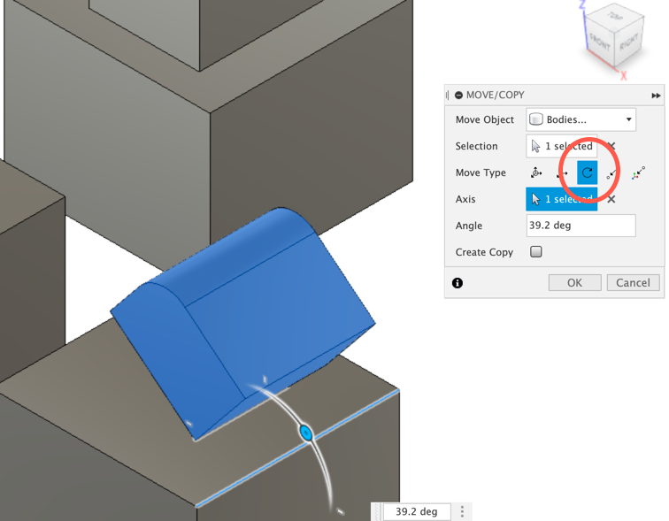

I want to jump on and say that I appreciate the explanation of why it's difficult, but nonetheless request the feature that move remember the values applied. See attached video. I need to reference this angle but it's gone forever. This is a frustrating experience as a user.
If nothing else, I think the default should be the translate mode and then when you switch to Triad mode there should be a popup warning that your values will not be remembered, and you should instead consider a combination of translate and rotate moves. Or the triad should create a series of translate and rotate moves in my timeline so I can access the move values. Thanks
Message 6 of 9
jeff_strater
if you use the Rotate tool here, instead of the Free Move, the angle is remembered, and is fully editable
