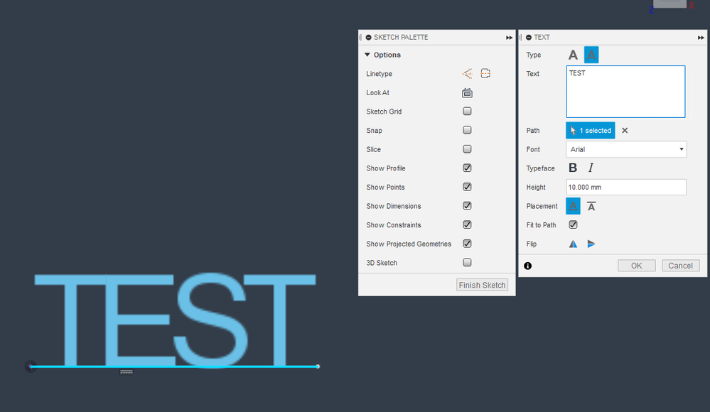

@hamocean If you use the text on path option you can check Fit To Path then you can dimension the length of the path to control the spacing, bigger or smaller.

To close the text spacing, it must apply the text to the path and then adjust the length of the path!
If so, could I know how to keep the spacing consistently close to the letters on each piece of text with a different number of characters?
