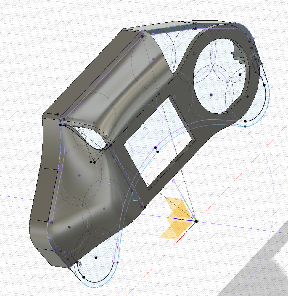

While I semi-solved (not useably) one side of this, I've got no idea how to loft to the side of the circle - what approach should I be using ?   (FYI - the "circle" is for a plug to screw into, and the square is for a switch)
I managed part of the above by creating control-point-splines for rails, then lofting 2 flat profiles.  It's not perfect, because (can't be seen in above) there's a slot in the back for gluing 2 sides together later, and that slot mucked up.

I basically need a "shell" of a constant thickness (e.g. 2mm) and I want to nicely join a hollow shape (the body) to a perpendicular flat end (the panel for the switch and plug) where the shapes involved are more complex than plain squares (e.g. one is a circle).
Maybe the only way is to spend all day sketching a pile of splines for rails in 3D ?  (I did semi-try that already, but Fusion360 is unhelpfully creating gaps between sections, which I then cannot fill in...)

I don't know if this is the right way or not, but I've almost solved this as follows:
I created a second sketch of the case-end offset by some random amount, then joined all the points with lines, in order to get a bunch of lines that I can later use for constraints of my fit-point splines.
I then joined the end to the switches with splines using 3D sketch.
I next added lines on the switch end at all teh join points, so I can also constrain the other ends of the splines
Then I used the "parallel" constraint on all the spline handles.
I created some surfaces and used those to split the switch place in a few strategic places (around the circular part).
And finally I can loft the case-end sketch to the side of the switch-panel body, using the splines as the rails...

The solution was to pay very close attention to the loft command dialogue - it often guesses the wrong tangent, so clicking the "change direction" icon is needed to get the lofts to go in the needed direction.
I had to change my idea about using only 2 pieces, into 3 instead - there's no room among the switch and plug parts to include a case-seam without causing a "bulge" that would press into the users legs - so I've opted for a separate endcap instead... which should make the plug soldering easier anyhow.
