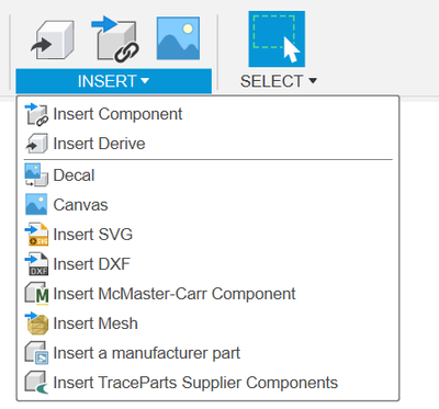

I have an assembly that is being designed that utilizes a lot of McMaster components through out. I am building subassembly/subcomponents of groups that get patterned out but as the design is changed I am needing to swap out different components in those sub assemblies. I understand that there is a replace component with linked parts in the design but not for natively built components. So what's the best process to able to easily remove and replace those components that get jointed?
As you have already discovered, "Replace Component" only works for linked components.
As such, delete and re-insert is unfortunately the best option.
If you are using fasteners, have you tried the new fasteners library that is built into Fusion ?
There, replacing existing fasteners is quick and easy.

Hi @TrippyLighting, I have a few questions about this part of your current answer.
1. Unfortunately, it seems that my version of Fusion does not have this option. Is this a me problem? I remember the feature existing previously.
2. What about for other convenient McMaster-Carr components, such as bearings? Are there better practices for inserting non-fastener components?
Additionally, a general question about McMaster-Carr component insertion.
3. Is it possible to insert only the body of a McMaster-Carr component through the embedded Fusion window, so that I can potentially keep a standard component as a linked file without any child components?
Your input is appreciated.
Connor
g-andresen
Inset Fastener is only possible in team mode and requires an activated history.
günther
campbellqn
As an FYI for anyone coming to read this later. A solution a buddy of mine came up with (haven't tests it my self yet) is to use a linked component in the design with the mcmaster part inside that linked component, make sure the mcmaster part is always joined/positioned relative to the origin in the linked design and join based on the origin of the linked design to the actual file you're working on. And use Edit in place if you need to swap out pieces.
