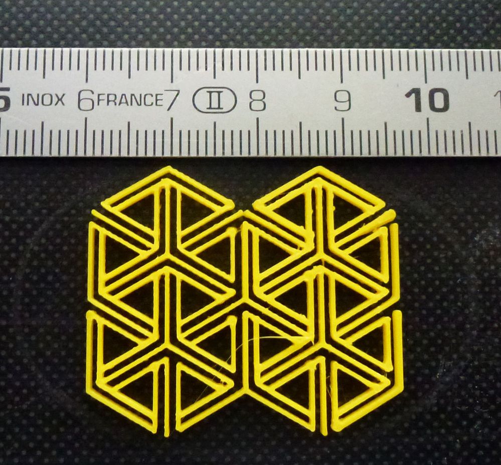

I know this is not a 3d printing forum, but my problem might be a defect in the model itself. Can you check the model and see if you can tell why it's not printing? All I get is the rectangular thin plate and the rectangular outline "frame". The geometric pattern is not printing!

The lines are 0.25 mm.
You would need a 0.25 nozzle to be able to print it.

wersy
It works if you set extrusion width to 0.24 mm.
But it won't be particularly accurate.
Message 6 of 11
rpsalas
Thanks all. That was it. I had a 1mm dimension but then I scaled it down forgetting that the wall would shrink.

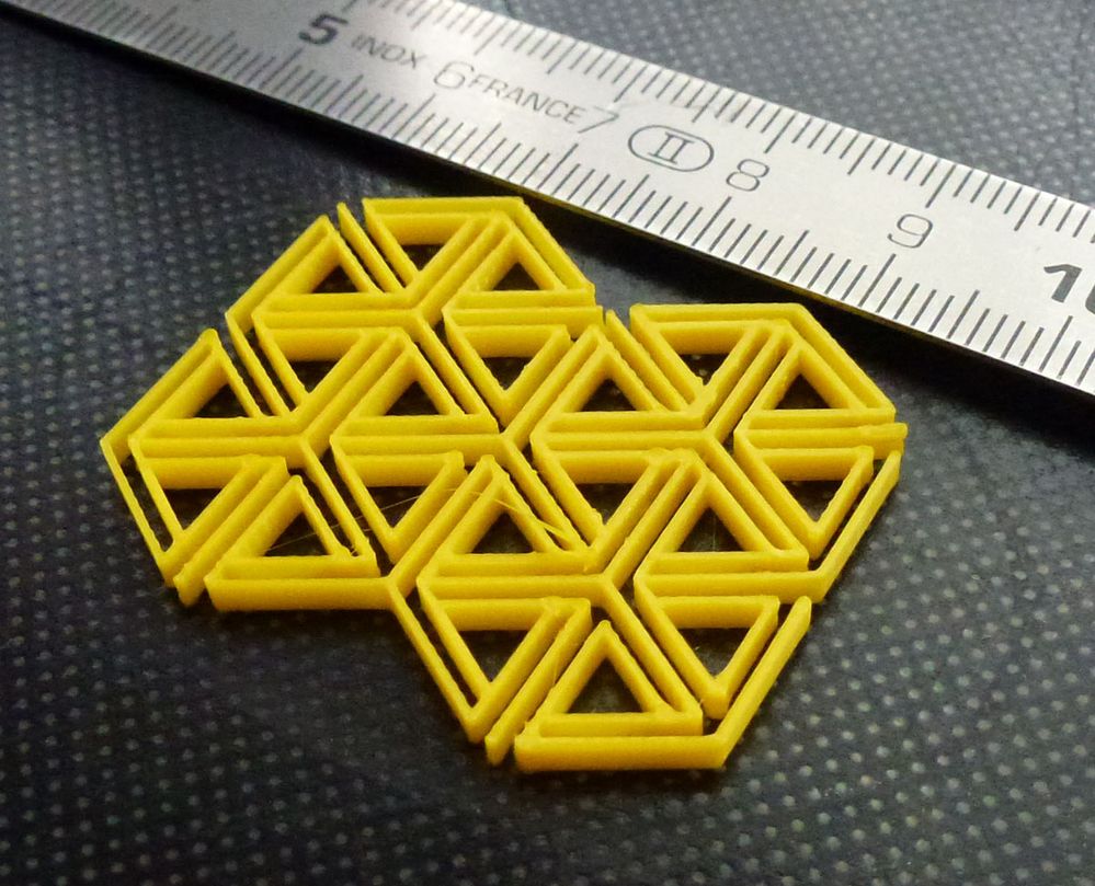

Message 8 of 11
wersy
Just printed a small part.
It works with nozzle 0.4, ew 0.24, lh 0.14.
As expected, not so accurate.
Try it out, you'll be surprised how good it actually looks with a little distance.

@rpsalas  schrieb:
Nice pattern though, right?
Yes it's nice 🙂
ew = extrusion width or line width.
This is a width that can be adjusted independently of the nozzle diameter.
lh = layer hight
Usually a value that is half the print width.
With a 0.4 nozzle, you can easily print with ew 0.3 and 0.6 mm.
It is not absolutely necessary to always change the nozzle.
I have been printing everything with a 0.5 nozzle on my self-built printer for 13 years
