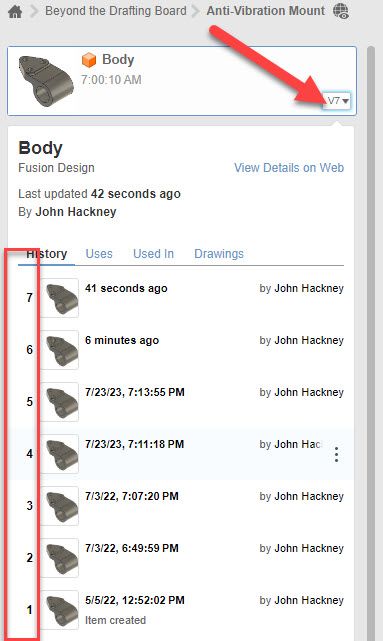

When using the compare versions I don't know what versions "A" and "B" is referring to?
I think its like I show in the pictures or do I miss something here?

The "Versions" of the model are shown in the Data Panel.  Every time you save a model a new version is created.  So when you are using the compare function, you can visualize the differences between different versions.  Create a model, save it as version 1, then modify it radically and save as version 2 then use the compare option to view the differences.
