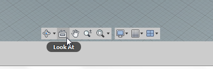

I believe this can be achieved with the look-at function/button.
This is one of the 5 buttons located and the bottom of the Fusion 360 screen.
HughesTooling
Have you tried using Look At, select a face or plane then click Look At, toolbar at the bottom of the work area. You can then right click Named Views in the browser and create a new view that can be used in the drawing workspace.

Thanks guys, absolutely correct.
Here is where those two commands are located.

You can define any planar surface as a named view, select it in design mode, and use it in the drawing for views.
