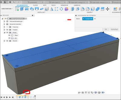

mango.freund
Hello @jhackney1972  yes, you're right, but an offset is from the object with an offset. that's what it's intended for. i don't hit my back when i have a leg pain, hahahhaa  😀.                     greetings mango
