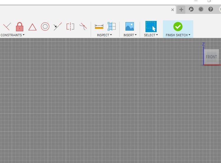

wmhazzard
At the top right corner of the sketch you will see "finish sketch"
If you can't figure it out, then attach an f3d file of your model to the next post.
