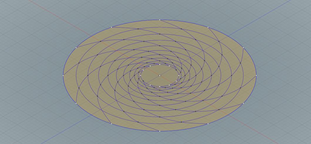

We build a loop which scans all the circles, from the more 'internal’ one to the more 'external’ and for every step we increment the angle of the line passing through the origin. All the intersection points create a curve which resembles a helix portion and can be considered as a spline on Fusion sketch.
Fig 5: Single spline
If we proceed counterclockwise and we scan every step of the ‘n’ number, we construct a set of independent splines. The same happens if we proceed in the opposite way.
Fig 6: counterclockwise splines
The intersections of all the splines build the set of all the triangles of the picture. The work is almost complete !
Fig 7: All the counterclockwise and clockwise splines
