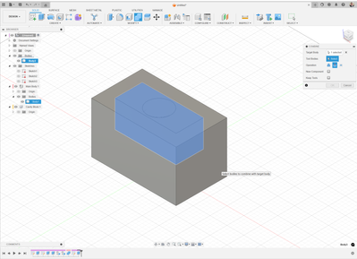

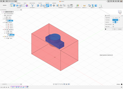

What you are asking is can I create a cutter using the real cavity a a mold. The answer is yes and it is fairly straight
forward operation and similar to what you have.
Take your actual cavity.
Create a simple sketch with a shape bigger than the cavity. Extrude the shape into a block.
Use a combine cut with the block being the body to cut the cavity body being the cutting tool.
What is left is a block in the shape of the cavity.
Save this a a component and use a your cutting tool for next time.

davebYYPCU
Not sure of your difficulty,
if you can make the cavity, then making the void into a body is pretty simple job.
placing the cavities where you want them, maybe a little more difficult.  Joints and components make simple work of that.
Combine command is the Boolean operations in Fusion.
Might help...

jandyman
Yes, that's exactly what I mean by "boolean", and it does indeed work
